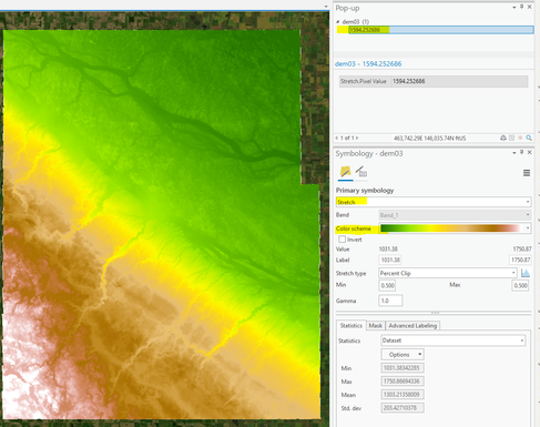

I just downloaded a raster DEM, and imported it into arcgis pro. Can someone tell me how to access that data, or just how to display elevations at certain places?  Thanks for any info you can give.
LyonMNGIS
The state of Minnesota has several workshops on how to use and visualize LiDAR (DEM) data. The pixel value (by clicking on identify) will be the height in elevation.  I like to visualize my data in the Elevation #10 color scheme.  With the LiDAR data you can create hillshades, contour lines, flow accumulations, etc...   Please look at the link below for more information.
Thanks
When you first load the data you will see a generic
Reference: https://www.mngeo.state.mn.us/chouse/elevation/lidar.html
