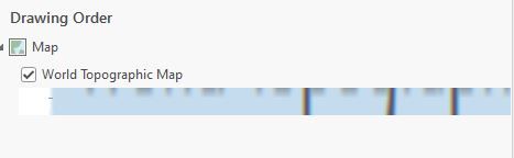

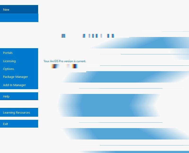

Recently, within the last few weeks I have been getting strange graphical errors on the UI of ArcPro and I cannot seem to fix them. (Images attached)UI Glitch 1.JPGUI Glitch 1.JPGUI Glitch 2.JPGUI Glitch 2.JPG
I have followed the technical support which directs me to change the display options, none of the changes has made a difference. I have updated graphics drivers, windows and ArcPro.

Typically the issue is not happening today, it does seem to happen sporadically so the next time it happens I will give this a try and let you know the outcome. Thank you for your suggestion.
ScottyMartin1992
So the problem just occurred again, I tried your method and it seems to have solved the issue, so thank you very much!
I think it may have to do something with my partner playing old games on my PC like the original RollerCoaster & Zoo tycoon games. I uninstalled them and have not had this issue for weeks, I then reinstalled the games on a different user profile this weekend and the problem returned the next time I booted up ArcPro after she played one of them.

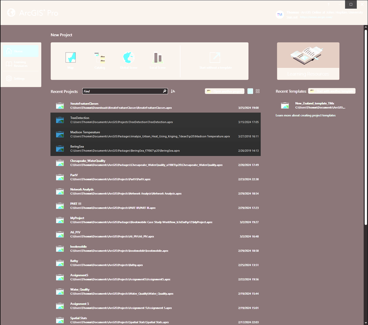

I had a similar, yet slightly different issue.  My interface looked like it was erroring out (like it had stopped responding), or would appear with different colors:
Putting the disable Hardware Acceleration in regedit also fixed the issue.  I hadn't had any issues after using this software for years and then it started today (26MAR24).  I wonder what changed?
