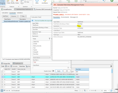

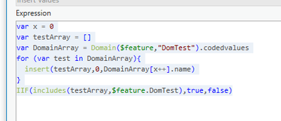

I wrote a constraint rule (first image below).
In the second image below you can see I added an attribute called DomTest to some test data.  I applied a domain call WetDry to that field.  Only a value of "WET" or "DRY" is allowed by the domain.  I then selected one record and used the field calculator to populate it with "KIM" (a clear violation of the domain) and it let me.
After I applied the constraint rule I tried to update one record again using the field calculator.  This time using "TIM" and the constraint rule stopped the edit.
