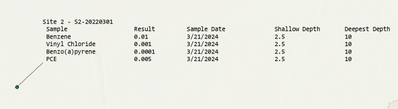

Currently it looks like this in the label:
With this code:

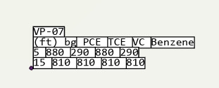

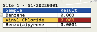

I would greatly appreciate if I could get the script updated to show like the original did using the attached Table_1_Test_Example

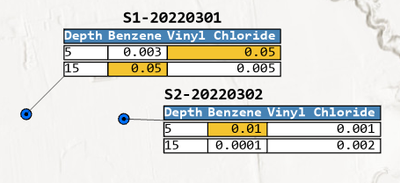

2. I was also wanting to get a version of this that used a shallowest and deepest depth field but was thinking the source data table needed to be formatted differently, wide vs long.
My end goal for the label on the 2nd example would be this:
What would the source table need to be formatted to and what would be the arcade expression for that?
Thanks in advance.
Chris

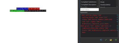

Take a look at the BGD style tag. That lets you apply a background color, outline, and padding. Everything you need to make it look like a table! Since your cells all have the same outline and padding, you could probably define those globally and just use the parameter to alter the color.
I'm not able to test it in Pro right now, but try adding another parameter to your FormatFont helper function.
// up at the top
var bgdGlobals= `width='1' padding='1' outline_black='100' outline_alpha='100' alpha='100'`
// other stuff…
// your function
function FormatFont(label, name, style, size, bgcol) {
    var tagName = IIF(name == "", "", `NAME='${name}'`);
    var tagStyle = IIF(style == "", "", `STYLE='${style}'`);
    var tagSize = IIF(size == 0, "", `SIZE='${size}'`);
    return `<FNT ${tagName} ${tagStyle} ${tagSize}><BGD ${bgdGlobals} ${bgcol}>${label}</BGD></FNT>`;
Then when you build your label, you can do something like this:
FormatFont(ljust(" Sample", clmwdth_s), textFontName, textFontStyle, 0, "blue='150'")
And I think that would do the trick.
Edit to add: to get it conditional to highlight exceeded values, you would probably just need an IIF statement in the final parameter.
FormatFont(
  'This could be highlighted',
  textFontName,
  textFontStyle,
  0,
  Iif(
    $feature['some_value'] > 0.001, // set threshold for highlighting as needed
    "red='200'", // adjust as needed to get your "highlight" color
    "red='255' blue='255' green='255'" // default to white
- Josh Carlson

Thanks for the response, Josh, wasn't able to get it to work on my end.
I would still like to get a version of the table label 1 to be formatted like the ESRI example with the additional fields, but when I try there is no expression error, but nothing appears for the label.

https://pro.arcgis.com/en/pro-app/latest/help/mapping/text/text-formatting-tags.htm#ESRI_SECTION1_DD...
I feel like it is possible somehow. Messing around in Pro, I can get some of the background attributes to work, but not all.
Similar to what you said, when I add things like padding or outline width, the labels disappear entirely. What version of Pro are you on? I'm on 3.2, I wonder if the other formatting tags were added later.

For the 2nd label type I am going for, I've attached an Excel file of example data.
This is the Arcade so far:

SetTextColor(black, FormatBO(white, black, 1, 0, FormatFont(ljust(" " + $feature.Test1Result_D1, clmwdth_r), textFontName, textFontStyle, 0))) +
SetTextColor(black, FormatBO(white, black, 1, 0, FormatFont(ljust(" " + $feature.Test2Result_D1, clmwdth_r), textFontName, textFontStyle, 0))) +
SetTextColor(black, FormatBO(white, black, 1, 0, FormatFont(ljust(" " + $feature.Test3Result_D1, clmwdth_r), textFontName, textFontStyle, 0))) +
SetTextColor(black, FormatBO(white, black, 1, 0, FormatFont(ljust(" " + $feature.Test4Result_D1, clmwdth_r), textFontName, textFontStyle, 0)))
counter+=1
// This section creates the second row of data, it refers to the D2 and D2 result fields
var counter = 0;
var table_result2 = ""
for (var sampleid in sampleid_fields){
table_result2 +=
SetTextColor(black, FormatBO(white, black, 1, 0, FormatFont(ljust(" " + $feature.D2, clmwdth_d), textFontName, textFontStyle, 0))) +
SetTextColor(black, FormatBO(white, black, 1, 0, FormatFont(ljust(" " + $feature.Test1Result_D2, clmwdth_r), textFontName, textFontStyle, 0))) +
SetTextColor(black, FormatBO(white, black, 1, 0, FormatFont(ljust(" " + $feature.Test2Result_D2, clmwdth_r), textFontName, textFontStyle, 0))) +
SetTextColor(black, FormatBO(white, black, 1, 0, FormatFont(ljust(" " + $feature.Test3Result_D2, clmwdth_r), textFontName, textFontStyle, 0))) +
SetTextColor(black, FormatBO(white, black, 1, 0, FormatFont(ljust(" " + $feature.Test4Result_D2, clmwdth_r), textFontName, textFontStyle, 0)))
counter+=1
// Final concatenated string
// This is where everything is pulled together for the final table - sample ID, column headers, iif statement is used to include multiple depths - if D2 is null only table results 1 (row 1) are included, if D2 is not null table results 1 (row 1) and table results 2 (row 2) are included
// Add a "\n" (carrige return) between each table row
// The LIN -3 is needed when using the 'Consolas' font to account for row height.
// The LIN leading value can be adjusted based on the type of font and font size selected.
 "<LIN leading = '-3' leading_type = 'extra'>" + SetTextColor(black, FormatBO(white, black, 1, 0, FormatFont(ljust($feature.SampleID, clmwdth_s), textFontName, textFontStyle, 0))) + "\n" + h1 + h2 + h3 + h4 + h5 + "\n" + IIF(IsEmpty($feature.D2), table_result1, table_result1 + "\n" + table_result2) + "</LIN>"
This is what the label looks like with the code:
Would like the table columns and rows to be uniform minus the Sample location on top. Look at attached image. There is also a field for Exceeds (Y or N), and it would be nice to highlight the ones that exceed.

Christopher_Spadi
Was able to figure out.
jcarlson
MVP Alum
Looks great! Nice work!
- Josh Carlson
Kendall County GIS
Christopher_Spadi
If anyone has a tip on how to get rid of the small gaps between the rows, please let me know. Everything I tried made the label disappear.
