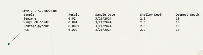

1. I wanted to modify it to add a few extra fields for a general label that highlights exceedances based off field with Y and N.
- I could get the extra fields added but the table background was giving me issues. Would like it to look like this format for the whole table:
Currently it looks like this in the label:
With this code:
// Define fields
var analyte_fields = [$feature.Test1, $feature.Test2, $feature.Test3, $feature.Test4];
var result_fields = [$feature.Test1Result, $feature.Test2Result, $feature.Test3Result, $feature.Test4Result];
var exceed_fields = [$feature.Test1Exceed, $feature.Test2Exceed, $feature.Test3Exceed, $feature.Test4Exceed];

$feature.SiteName + " - " + $feature.SampleID + "\n" + h1 + h2 + h4 + h5 + h6 + "\n" + table_result;
I would greatly appreciate if I could get the script updated to show like the original did using the attached Table_1_Test_Example

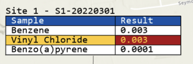

Take a look at the BGD style tag. That lets you apply a background color, outline, and padding. Everything you need to make it look like a table! Since your cells all have the same outline and padding, you could probably define those globally and just use the parameter to alter the color.
I'm not able to test it in Pro right now, but try adding another parameter to your FormatFont helper function.
// up at the top
var bgdGlobals= `width='1' padding='1' outline_black='100' outline_alpha='100' alpha='100'`
// other stuff…
// your function
function FormatFont(label, name, style, size, bgcol) {
    var tagName = IIF(name == "", "", `NAME='${name}'`);
    var tagStyle = IIF(style == "", "", `STYLE='${style}'`);
    var tagSize = IIF(size == 0, "", `SIZE='${size}'`);
    return `<FNT ${tagName} ${tagStyle} ${tagSize}><BGD ${bgdGlobals} ${bgcol}>${label}</BGD></FNT>`;
Then when you build your label, you can do something like this:
FormatFont(ljust(" Sample", clmwdth_s), textFontName, textFontStyle, 0, "blue='150'")
And I think that would do the trick.
Edit to add: to get it conditional to highlight exceeded values, you would probably just need an IIF statement in the final parameter.
FormatFont(
  'This could be highlighted',
  textFontName,
  textFontStyle,
  0,
  Iif(
    $feature['some_value'] > 0.001, // set threshold for highlighting as needed
    "red='200'", // adjust as needed to get your "highlight" color
    "red='255' blue='255' green='255'" // default to white
- Josh Carlson

I would still like to get a version of the table label 1 to be formatted like the ESRI example with the additional fields, but when I try there is no expression error, but nothing appears for the label.
jcarlson
MVP Alum
https://pro.arcgis.com/en/pro-app/latest/help/mapping/text/text-formatting-tags.htm#ESRI_SECTION1_DD...
I feel like it is possible somehow. Messing around in Pro, I can get some of the background attributes to work, but not all.
Similar to what you said, when I add things like padding or outline width, the labels disappear entirely. What version of Pro are you on? I'm on 3.2, I wonder if the other formatting tags were added later.

This is what the label looks like with the code:
Would like the table columns and rows to be uniform minus the Sample location on top. Look at attached image. There is also a field for Exceeds (Y or N), and it would be nice to highlight the ones that exceed.
