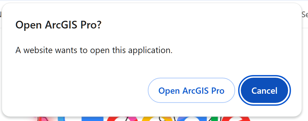

I get this box but when I click Open ArcGIS Pro nothing happens.

And again I get the box above but nothing opens.

Also tried to a file on the system.  But again just the Open ArcGIS  Pro box and nothing happens.

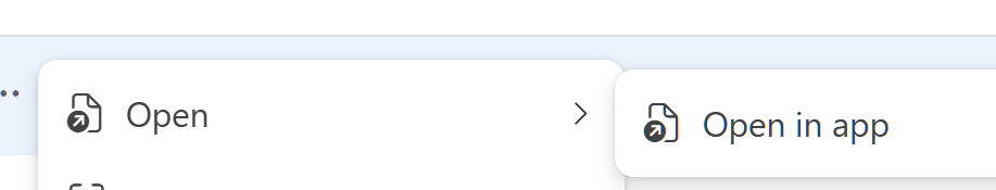

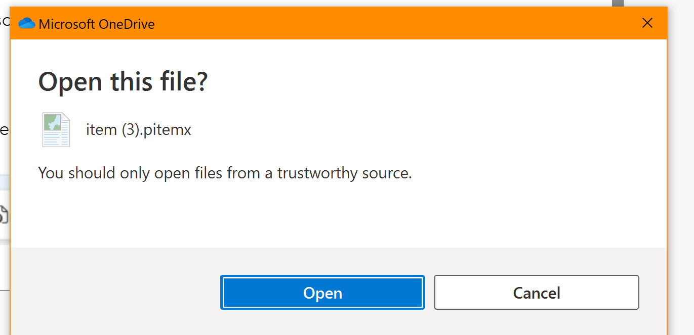

If in Sharepoint I click Open then Open App
I get this box which does open Pro but that is 3 extra clicks.
