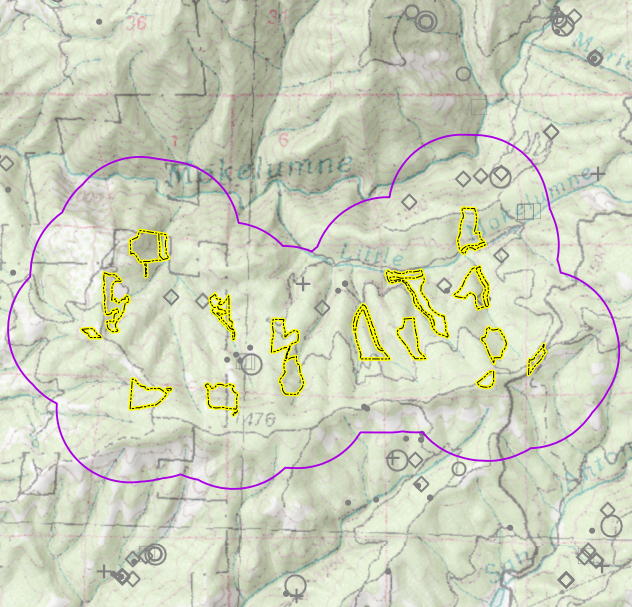

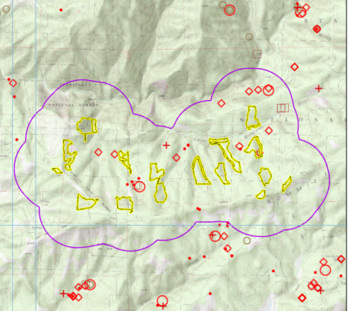

The symbology and color for a layer in my map looks fine in ArcGIS Pro, but the moment I export it out as a PDF - both the legend and symbology lose its color, defaulting(?) to a grey color.
I've made this kind of map before using this same layer with no issues and I'm unsure why it's acting up now.
(How the map looks in ArcGIS Pro)
(How the map looks when I export it out as a PDF)

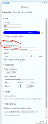

I had trouble with this as well.  I corrected the problem after some trial and error.  On the Export Layout pane under the Compression group of commands is an options for "Output as Image" that I had to check the box.  That fixed the problem.

The layer in question (red symbology in first picture) has a few different colors and symbols that are not shown (circles, squares, red, brown, grey) but the moment I export it out as a .PDF and view it (adobe, foxit, chrome, edge), all the symbols become grey.
NW_-_RogerHart__GISS_
This is the Export pane I have. The item circled in red is the option I chose to make it not be grey.  If you have different options it might be a licensing thing.
