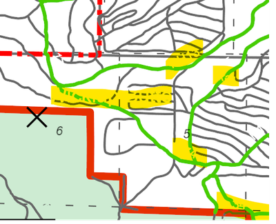

Hello,
Was importing a layout from ArcMap to Pro and everything went fine but when I went to upgrade the annotation layer through the Upgrade Dataset tool it completed destroyed all of my annotations (attribute table is empty) and whats worse is it turned all the annotations white but they are not selectable and when I remove the annotation layer they stay were they are. I've exported and reimported the layout, I've reopened the project.
I dont know what else to try and am thoroughly peeved that the tool would just delete everything when it fails. Do I just have to start from complete scratch?
Edit: They are not all white, it seems to be causing a bug where the symbology of any line feature behind the annotation is no longer being drawn.

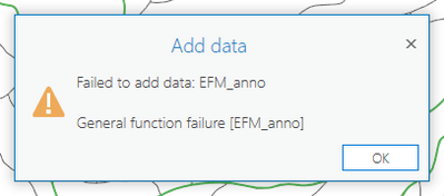

  3. Can you add the annotation feature class to a new empty map?
    1. No it gives an error:
    2. If so, what is the result?

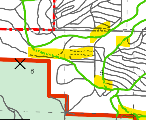

    1. Uploaded, the bad one is 'EFM_anno' and it should look very similar to 'EFM_anno_post_upgrade' which I reconstructed after the first one got corrupted.
Thanks Robert appreciate the help!
ccowin_odfw
OK so I figured out that it was a separate feature layer that was acting as a transparent halo. What was weird is that I had this layer disabled but it was still showing up. When I removed it entirely everything started to draw correctly.
