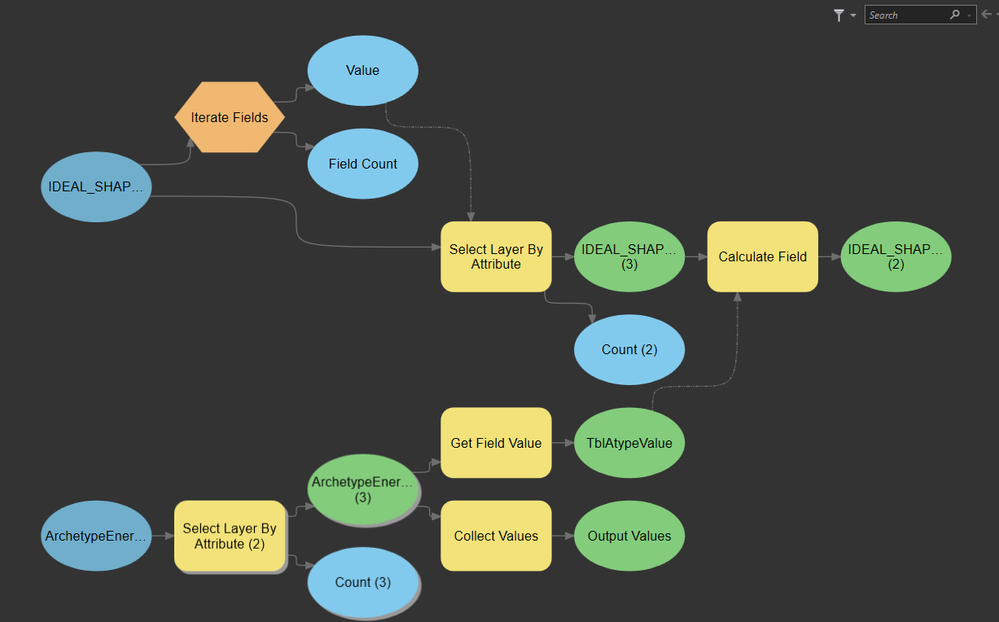

I want to create a tool either from Python or in ModelBuilder, but I am stuck at the last part.
I have a feature class and a lookup table. Field names aliases in feature class are the same as!ARCHETYPE! Value in a Lookup table.
Stand-alone table name: Tbl_HData
**Feature class name: FC_HData

HussainMalik1
Thanks, @DavidPike, for the response.
Yes, you are right about the expression. I forgot to close (!Small Multiplex built >= 2007! + !Large Multiplex built < 2007!) In brackets.
About your first point:
I could have done that if the!ARCHETYPE! field in FC_HData wasn't concatenated. I am counting each value in the ARCHETYPE field and creating new fields with archetype names as the field name. I have been struggling with this problem for a few days now but didn't get any luck.  I tried to do it in ModelBuilder with Iterate Fields, but it doesn't select layers correctly for multiple fields.
I am primarily trying to select records for Archetype and Year in  Tbl_HDATA and locate the fields with the same name in FC_HData.  In my head, this logic seems easy to do in python, but unfortunately, my python skills are fundamental, but I think Search and update Cursor would do the magic.
