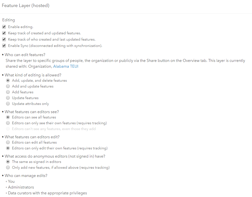

I'm trying to have a colleague help me review and update data in some tables.  However, she get's an "Update table row failed. General function failure [No permission to edit the specified feature.]" shown below.
I double checked to make sure she was added to the group on AGOL and feature layer hosted.  How do I make sure she is a data curator with the appropriate privileges?

Estella,
One item I noted in your setting is "Editors can only edit their own features" is enabled.  Please take a look at Manage hosted feature layers on the AGOL website.
If you want to restrict feature edits based on the creator of the feature, select Editors can only edit their own features (requires tracking) under the What features can editors edit? setting. This allows editors to delete or modify the features they created but not delete or modify others' features.

Thank you Lance.  I did not catch that in the settings.  I will make that change and have my colleague test out the feature layer to make some modifications.
