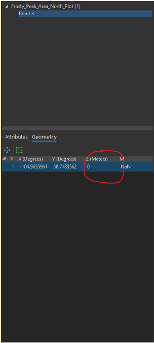

I know the Z value is blank but How do I update the fields ?
Is there a way around for me to do this to update the Z (Meters) ?

To edit  values of a vertex or point: from the Edit tab > click Modify > click Vertices and the Edit Vertices pane opens. You can change x,y, and z in the table at the bottom of the pane:
You can also launch the Edit Vertices from the Attributes pane, Geometry tab. The button is next to the Move button.

Hi Scott, after I posted this and then you replied to me, what I find the easiest way to do this ...
First I would start setting everything up in 2D and then convert it to either global or local scene and then when you open it  Create a new layer ( Map Notes points )  to use to input the x,y,z in Agisoft Metashape , it is a 3D programmetery software, that you can use for Drones  just like you have at ESRI have Drones2Maps..
You just plot where you see features on the map and then populate their names , etc..
If you turn it over to it's attributes and in the Geometry, the X, Y,Z (meters) show up..
I then copy them to Agisoft Metashape.
That is what I do.
Scott_Harris
Hey Robert, that's a good tip and it works because when you create a scene in ArcGIS Pro, the scene gets a default elevation surface called the Terrain 3D layer that it can use to populate z-values on the features you create:

When I first use the  Map Note points layer in 2D and I populated the fields for Long, Lat, and Altitude (Elevation)..
I didn't realized that in 2D it will show only Long and Lat  in the Map Notes Points' Geometry but not the Altitude  I had to add it to 3D Local Scene in Pro.
The field column I had for altitude had zeros and then didn't realized that when I right click on the Altitude field and it came up said "Calculate Geometry"   I ran it and then it doesn't populated but shown 0
Any reason why ?
I am using GCS WGS 84
Thanks
Scott_Harris
Robert,
If you are using Calculate Geometry (actually the Calculate Geometry Attributes geoprocessing tool), and you choose Point z-coordinate for the property, you should get the z-value that's stored on the point.
Prior to running the tool, you can check what this is using the Edit Vertices tool like I described in this thread above (https://community.esri.com/message/886772-re-update-field-attribute-question?commentID=886772&et=wat...)
If it's 0 there, you're going to get 0 for a result when you run Calculate Geometry.
-Scott
