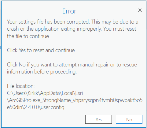

HelloMiguel Paredes‌ !
Are you (or Robert Krisher) able to get this running with 2.4.2?
I get this at startup:
Hope you are doing well,
Kirk
by Anonymous User
Not applicable
Nevermind.  Fixed it by moving the system.net element so that it is AFTER the configSections element.
