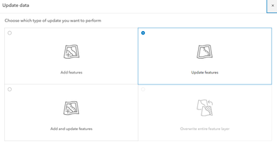

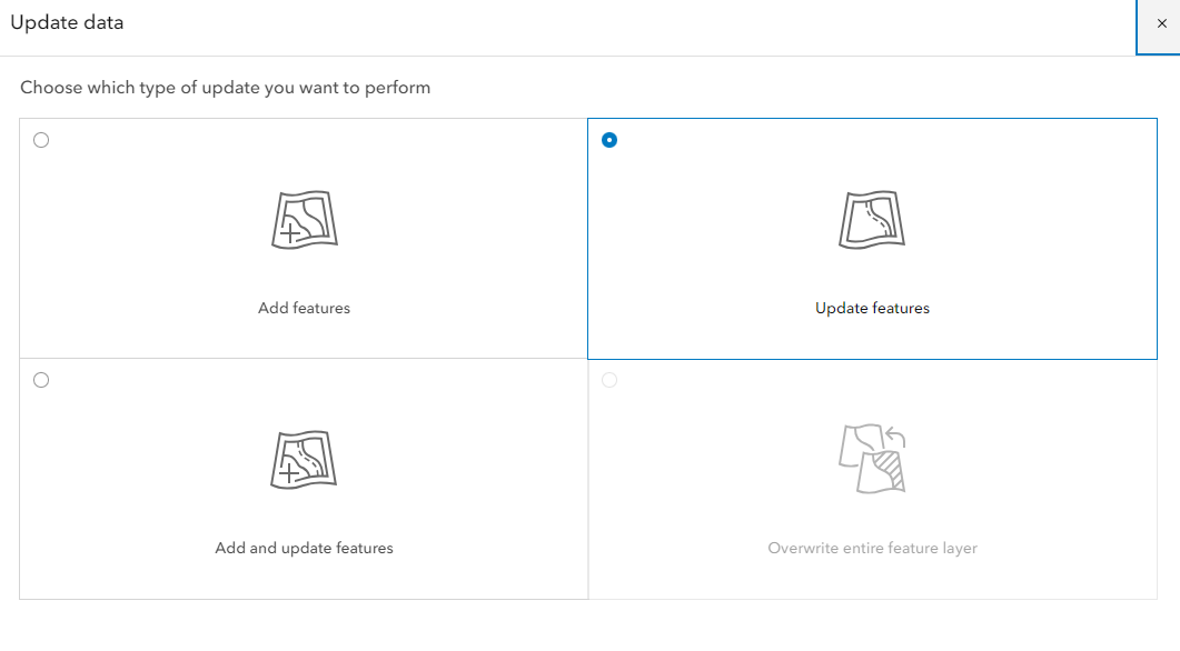

ArcGIS Online has a nice wizard for hosted feature layers called Update data. It will edit feature attribute or geometry via a table match with an uploaded data set. Is there a similar tool or geoproccess in ArcGIS Pro?
I'm aware the process could very simply be done with a series of geoprocesses like table join, calculate field, truncate, or append, but I was wondering if there was a similar tool that bundled all that into one like ArcGIS Online does.

I have not tested it, but the Pro Append GP tool has an 'upsert' option which does this.

You are right, that looks like it does the same kind of update. I guess I always ignored that parameter for some reason. Thanks!
