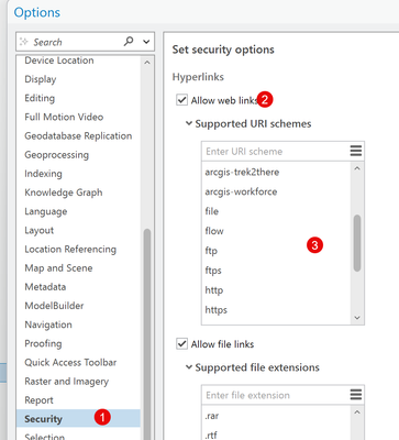

Set security options—ArcGIS Pro | Documentation
I suspect you will have to experiment if you can put the text with the image from the Project Options, Security section
