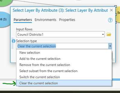

In a model I merge a number of feature classes, this input is parameterized. Before it starts merging, I want to unselect all features in these feature classes to avoid problems with accidentally selected features.
I would like to do something like this example within the Mergetool:
https://community.esri.com/t5/image/serverpage/image-id/16617i12F3980F8E9FEC87/image-size/medium?v=v...

If you are using featureclasses (aka, path to the data on disk) selections aren't used.
If you are using featurelayers then selections are honored.
Use featureclasses as your inputs, not featurelayers
