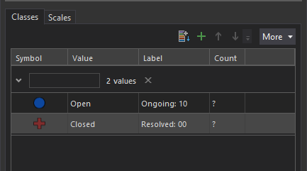

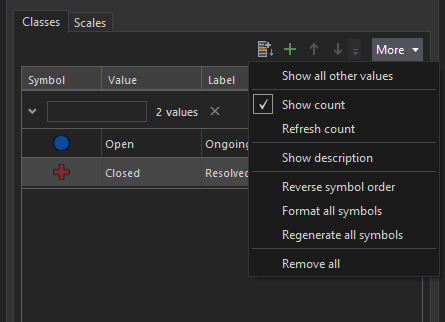

Sorry for the slow response on my end, this is the expression that I am using within the Symbology tab:
WHEN(
$feature.CASE_STATUS == "Open - Founded", "Open",
$feature.CASE_STATUS == "Open - Pending", "Open",
"Closed")
This data is comprised of inspection case records with a possibility of 4 different statuses; however, for reporting purposes, I've been asked to show status as either open/closed. The above snippet changes two of the statuses to a singular: "open" and I rely on the default option to force the others into a "closed" status. When using an Arcade expression, the count data continues to show as a "?" but when using one of the regular columns the count feature works as intended. My band-aid solution was to manually count the records with a selection sort and then write that into the label.
Arcade1
Arcade2
Regular Column
Let me know what you think,

Hi Xander Bakker‌, here's what a sample of my data looks like. Let me know if you'd like anything further.
XanderBakker
Esri Esteemed Contributor
Hi Jordan Carmona ,
I don't see anything strange in your data, the values are there and your expression is correct, The field does not have a domain defined (so you are not checking against domain codes). The only thing I can think off is that there might be an additional space or something that can break the expression.
Could you try this?
return Split($feature.CASE_STATUS, " ")[0];
It will split the text using the space and take the first element which should result in Open or Closed
