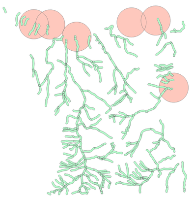

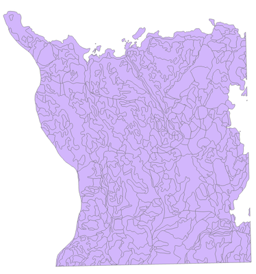

There are 3 of feature classes in the geodatabase:
- polygon standsCD,
- StreamsCD_Buffer_Union buffer symbolized in unique values of the S_Distance attribute,
- output feature class from the Union geoprocessing tool.

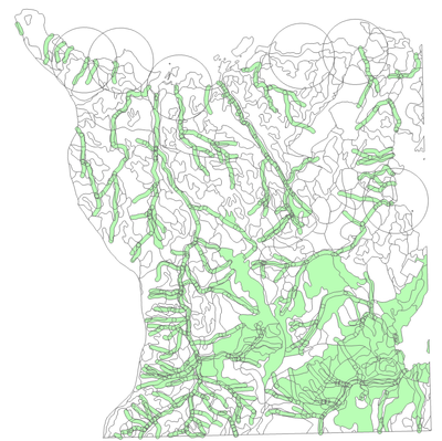

The Union tool cannot handle a simple union of the first two feature classes. Some objects are assigned wrong values for the S_Distance attribute. In the connected polygons located outside surface stream buffers, the S_Distance attribute value should be 0, and for a many of features the tool incorrectly assigns an attribute value of 50.
It seems to me that this is a very serious error of the application, making it virtually impossible to use it in analyses.

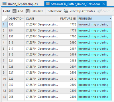

Tomek, I used the Esri validation method in Check Geometry if you need to report that.

ESRI Polska checked the data from the StreamsCD_Buffer_Union set. These are data from two buffers (from the ESRI tutorial) combined with the Union tool. The Check Geometry (Data Management) tool showed geometry errors. So either the Buffer or Union tool generated some errors. These errors were corrected with the Repair Geometry (Data Management) tool. After this procedure, the analysis showed no errors.
