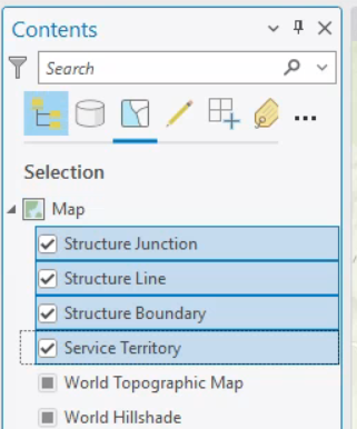

MitchHolley1
MVP Alum
If you go to Contents pane in the 'Selection' tab, you can select all the layers you want to turn on, then hold CTRL + SPACE bar. That should select/unselect the layers.
