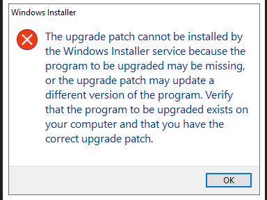

Hi, I am trying to upgrade ArcGIS Pro from 2.4.3 to 2.9.5. When I try to do it directly I get this error
I updated 2.4.2 to 2.4.3 without problems and thought the issue was that I was jumping patches but when I try to update from 2.4.3 to 2.5.1 I get the same error.

Kayden - this makes sense as patch updates (i.e. 2.5.0 ->  2.5.1 or 2.5.2) require 2.5 to be installed first.  You cannot go from 2.4.2 to 2.5.5 without installing 2.5.0 to begin with.  My recommendation is to do a complete uninstall of ArcGIS Pro 2.4.x and a new install of ArcGIS Pro 2.5.0.  Then you will prompted to update ArcGIS Pro 2.5.0 with the patches.  Let me know how it goes.

Unless you need something added in 2.9.4 or 2.9.5, I would recommend only installing up to 2.9.3 though.  Several issues arose with 2.9.4 and not fixed as of 3.0.2, especially if you are connecting to AGOL data with attachments.
