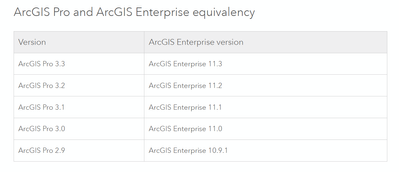

Are you able to overwrite services using any ArcGIS Pro 3.x version? Because I believe you should still be able to open ArcGIS Pro projects saved in 3.3 in 3.0, 3.1, 3.2, etc.
But generally, it's recommended that your ArcGIS Pro version and Enterprise version "match" each other. The further apart the two versions are, the more likely you're going to run into problems you're experiencing. I've unfortunately learned that lesson the hard way.
