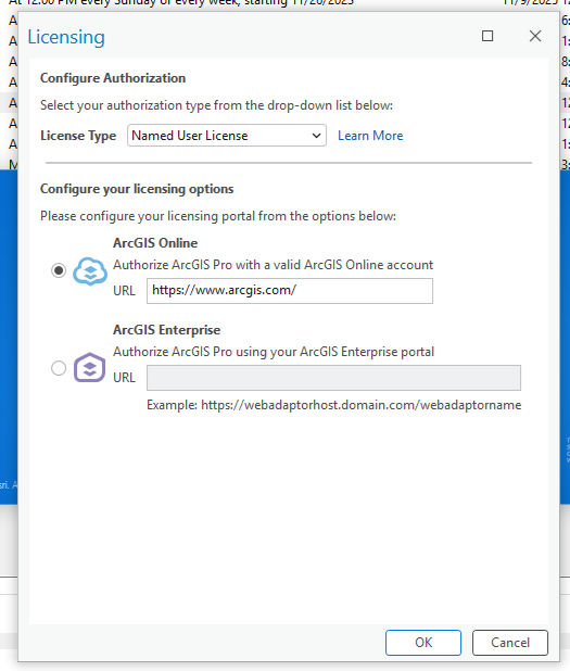

I am trying to start Pro on one of our machines and I keep getting an "Unable to establish connection to https://www.arcgis.com/" error. I stumbled upon this article but I don't even get a sign in screen
https://support.esri.com/en-us/knowledge-base/problem-unable-to-sign-in-to-arcgis-online-or-portal-f...
Any help would be appreciated as some of our public facing tools are not working.

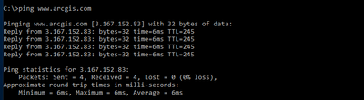

Would it be possible to restart the machine? It may be a DNS or DHCP issue on the machine side that could be stopping it, I would try using the command prompt to ping "www.arcgis.com" and see if it hits properly as well.
Cody
luckachi
I restarted the machine this morning and no change. I will try the command prompt ping right now

Hey @luckachi
Thank you for testing this out! Since the ping goes through you can connect which is good! I would try giving Pro a soft reset like this here:ArcGIS Pro Soft Reset
After this, my only other suggestion would be to reinstall ArcGIS Pro, then contact Esri Support, could you also attach a screenshot of the connection error?

Soft reset didn't work 😞 but I noticed that the StrongName folder doesn't exist in my local folder (even after the restart ). Will be following up with ESRI support.
luckachi
In case anyone else experiences this issue. This machine runs Windows Server 2019 with IIS Crypto security. We had to enable the 'best practices' option for TLS which enabled TLS 1.0, 1.1 and 1.2 (1.2 had already been enabled and we disabled 1.0) - apparently TLS 1.1 was necessary to establish a connection via Pro.
