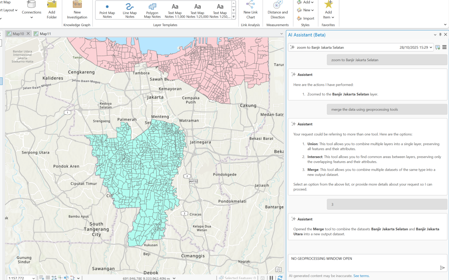

I’m experiencing an issue with the AI Assistant in ArcGIS Pro. When I ask the assistant to open or run any geoprocessing tool (such as Buffer, Clip, or Spatial Join), it does not respond to the command — the tool window does not open, and no process is executed.
Is there any additional configuration, permission, or setting required for the AI Assistant to access or execute geoprocessing tools?
Or is this functionality not yet fully supported by the AI Assistant in the current version of ArcGIS Pro?
Thank you for your help.

However, in the following demo video, at 4:03👉 https://youtu.be/G0_PZrD8j2Q?t=243
the presenter shows that the AI Assistant Action can successfully open the Geoprocessing Toolbox window.
In my case, when I try the same prompt, the toolbox window does not appear.
