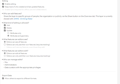

I shared as overwrite, this time going to the Configuration tab on the Overwrite tool and enabling editing there, as well as unchecking the z-values box. This did publish with editing enabled (yay!), but the editing tab in the Portal shows fewer options than other features. I'm happy to have editing enabled, but am curious about the differences between the features.

Eugene_Adkins
It looks like Editor Tracking is enabled on the other layers but not the one in question, which would answer the first difference. The other difference I'm not certain about. Perhaps it's looking at something unique created when a hosted feature layer is created? I do not see the same options with creating/overwriting a web layer on my side, even though I'm using Pro 3.1.1 and Portal 10.9.1. Perhaps there's a difference in our server versions?
