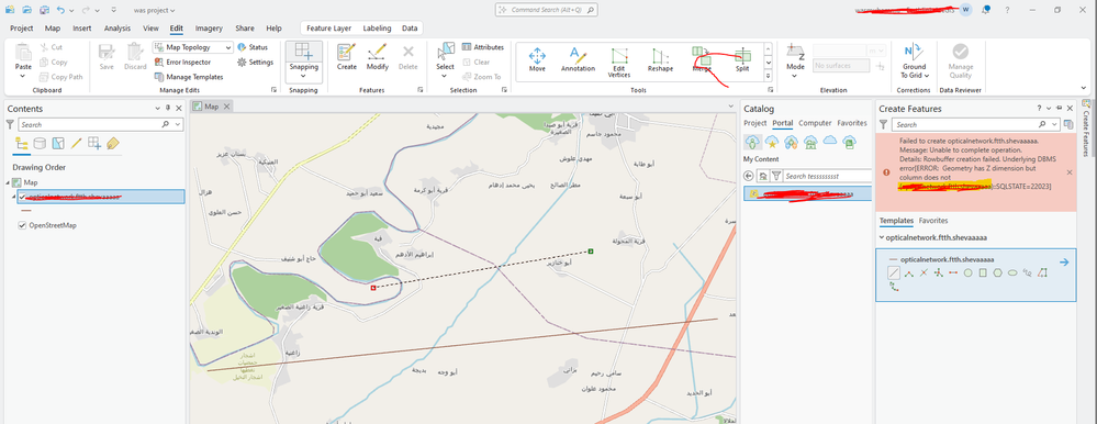

wasfymohammed
George_Thompson
Esri Notable Contributor
I would recommend contacting Technical Support on this. It may take more detailed troubleshooting than we can accomplish in this forum.
If you enable the database as a geodatabase and register that layer with the geodatabase, I wonder if the behavior is different.
--- George T.
