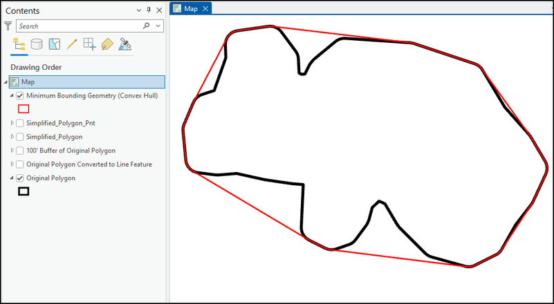

Thank you for the suggestion. I hadn't worked with convex hulls before, but after a bit of experimentation I was never able to get the result to conform as tightly to the original polygon as I need. Here is an image of my original polygon and the convex hull result:
It seems like that would be the solution if I could get the result to conform more tightly to those inward bends in my original polygon.

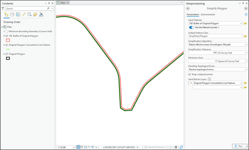

As for the workflow I described originally, here are some images to better explain what I did
Here is the original polygon I want simplified
I created a 100' buffer of the original polygon, as well as converted the original polygon to a line feature (I zoomed in to the northern portion of my original polygon so you can see the detail). These new features will be used in the Simplify Polygon interface

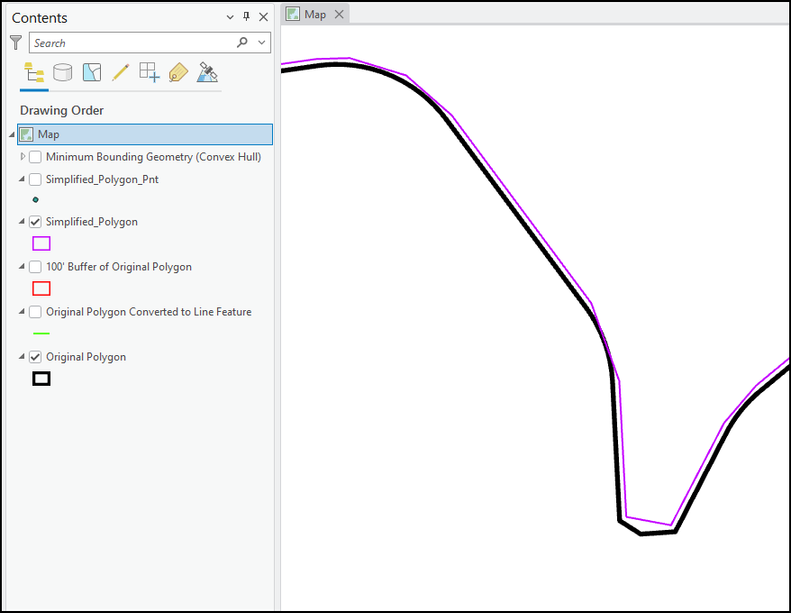

And here is my result. As you can see, it is the buffered polygon that is actually being simplified, and the original-polygon-converted-to-line used as a barrier layer. So the result is not ideal in that it's not actually simplifying the original polygon, but satisfies my need to have all the resulting vertices located outside the original polygon.
