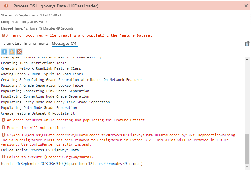

Hi all,
After 12 hours of successful processing UKDataLoader failed with OS paths and roads. This is the error-
G:\ArcGIS\AddIns\UKDataLoaderNew\UKDataLoader.tbx#ProcessOSHighwaysData_UKDataLoader.py:363: DeprecationWarning: The SafeConfigParser class has been renamed to ConfigParser in Python 3.2. This alias will be removed in future versions. Use ConfigParser directly instead.
Has anyone else had this issue and if so how was it resolved? We use this tool all the time for updating OS mapping and never had this problem before.
Thanks
Dave

Hello @davidchamberlain2  , as a first step you should try this with the latest versions of UK Data Loader (v7.1.1) and ArcGIS Pro (v3.1.3). If you still see problems then please open a support case with Esri UK.

Hi Chris,
Thanks for the reply. I logged a ticket with ESRI and they have the same issue as me when using the same data and tools. I have a meeting with them later this week. So I will accept your input as a solution.
Thanks again
Dave
