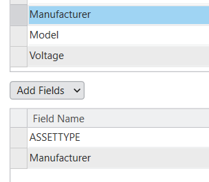

Hello all. We are currently upgrading our esri/arcgis versions and in arcgis 3.5 there is a warning message regarding contingent values.
The message states "contingent attribute validation was not performed because one or more field groups contained fields with multiple values"
There is no more context to the message and I am still allowed to edit the feature. This is on the Electric Device feature class (we are using utility network) and in our current production version (arcgis 2.9) there is no warning or error.
Does anyone have any more detail on that message? The only thing I can relate it to is that we have two field groups which both contain the Manufacturer attribute. Could that be the cause? I could likely accomplish the same goal by removing one field group if that is the cause. tia

So the field group set up is not an issue?
Now I look back at it, the same could be accomplished with just the Model field group, yes?
JenniferCadkin
I do not think your field groups are an issue based on your original question; selected features have different attributes and the Contingent Attribute validation does not execute on 'different values.'  This does not indicate there is a problem with the schema itself.
And from your screenshots it does appear you can simplify the Contingent Values schema.
