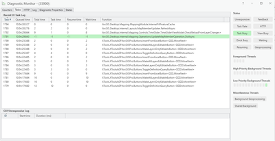

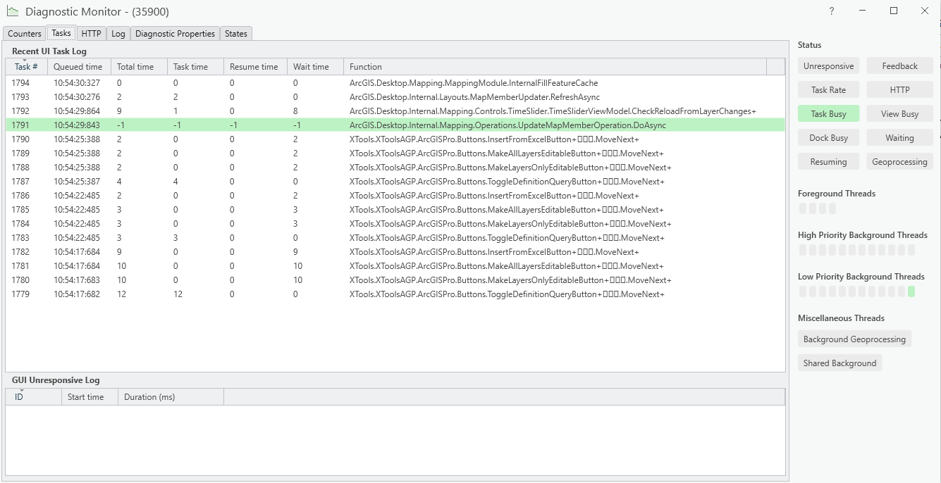

I attempted to run the Diagnostic Monitor while trying to turn a layer off, and noticed a single task that never seems to finish running - ArcGIS.Desktop.Internal.Mapping.Operations.UpdateMapMember.Operation.DoAsync:

Good morning - I see a related Support Case of a user experiencing the same issue as you.  It was related to XTools being installed on the same computer as ArcGIS Pro.  Do you have XTools installed and if so, can you uninstall to see if this behavior is repeated or is now operating normally?

I missed that, thank you for pointing it out! And I do have XTools installed. I will try that.

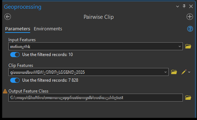

I've got no XTools, but since upgrading to ArcGIS Pro 3.2 I have the same problem with interface freezing while turning layers on/off after running geoprocessing tools with layers that have definition query.
For example, interface freezing begins after Pairwise Clip of two feature classes from DBMS (MS SQL)
