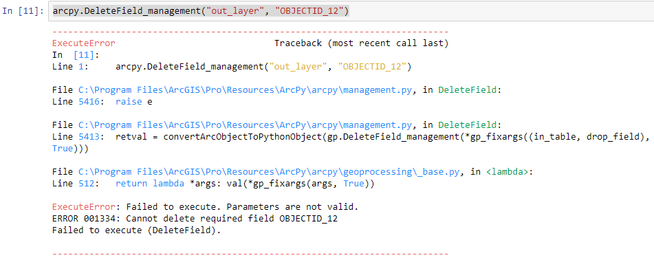

arcpy.DeleteField_management("out_layer", "OBJECTID_12")
And...that throws an error:
I've tried this with several of the other field names.  Also tried it with a list of the field names.  Also tried it with single quotes instead of double quotes.

Your OBJECTID_12 may be a required field, which is permanent and cannot be deleted, as the error message description says.
https://pro.arcgis.com/en/pro-app/latest/tool-reference/tool-errors-and-warnings/001001-010000/tool-...

Perhaps the table has a temporary join then, which would make the id field required and unable to delete the other fields as well

There is a difference between a "feature class" and a "feature layer". The class ist the physical object stored in the database. The layer is (very roughly speaking) a representation of that class, which allows you to do certain things that you can't do directly with the class (e.g. selection, symbology).
So when you make a feature layer of Brighton_Zoning, this is NOT a copy. If you succeed deleting a field from the layer, it will be deleted from the underlying feature class, too!
