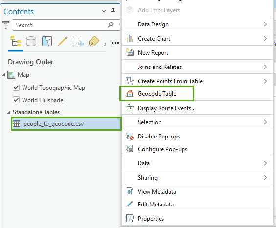

BobBooth1
Instead of creating XY coordinates, try:
1. Add the CSV table to ArcGIS Pro
2. In the Contents pane, right-click the table and click Geocode Table.
3 .Step through the wizard:
4. Choose the ArcGIS World Geocoding Service (this will consume credits at a rate of 40cr/1000 addresses).
5. Specify one field (the zipcode field).
6. Specify US locations.
7. Specify the type of locations (Address, Postal, Populated places).
Check the credit use and run the tool.
You should get back points - one feature per row, at the zipcode centroid.
