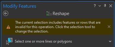

For me, the issue was an unknown coordinate system when trying to select and Edit [Reshape] a feature.
The current selection includes features or rows that are invalid for this operation. Click the selection tool to change the selection.
You can get more info by looking under the Edit [pencil] tab in the Contents Pane and then hovering over the red exclamation point for the layer in question.
