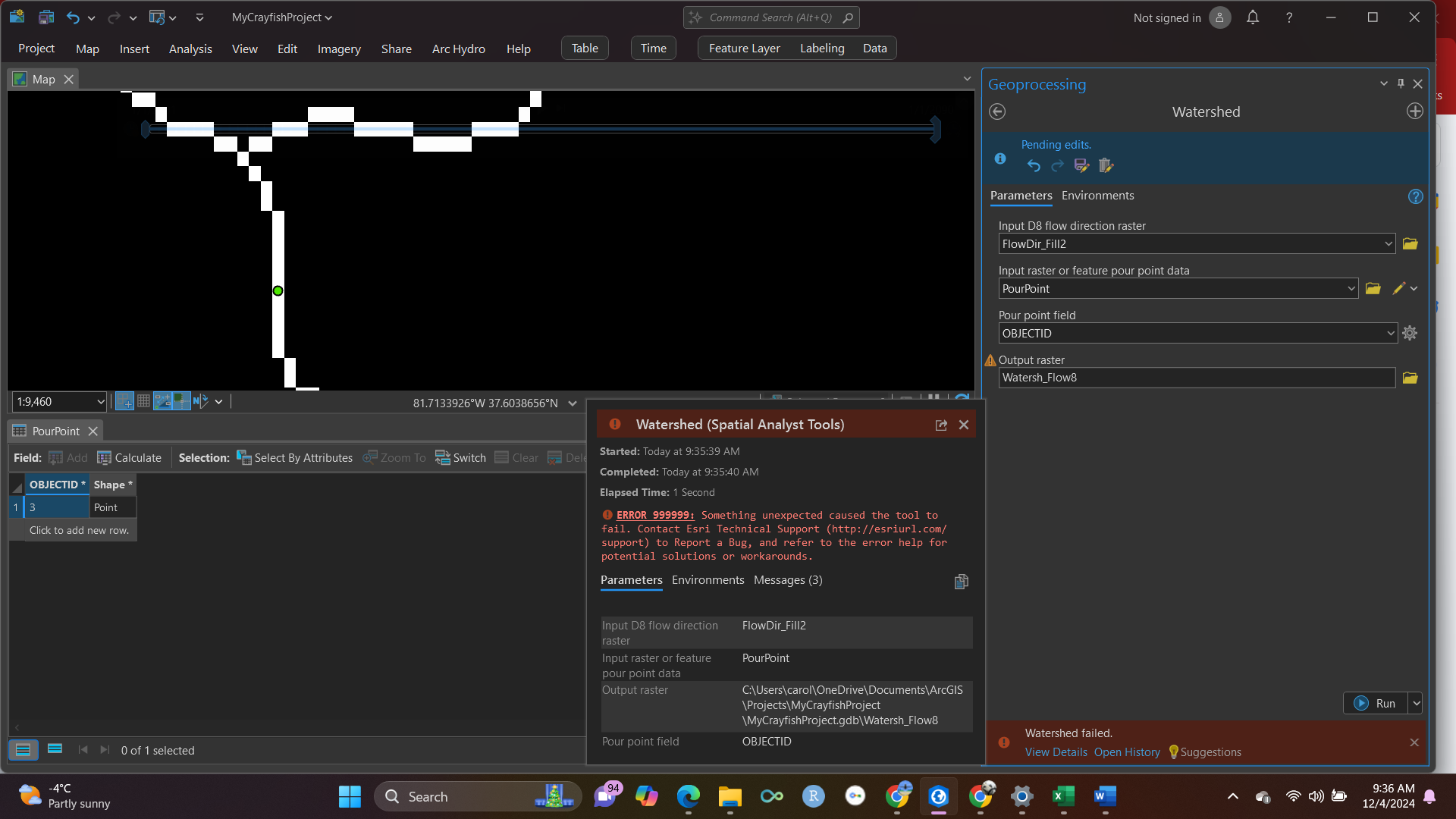

Greetings!

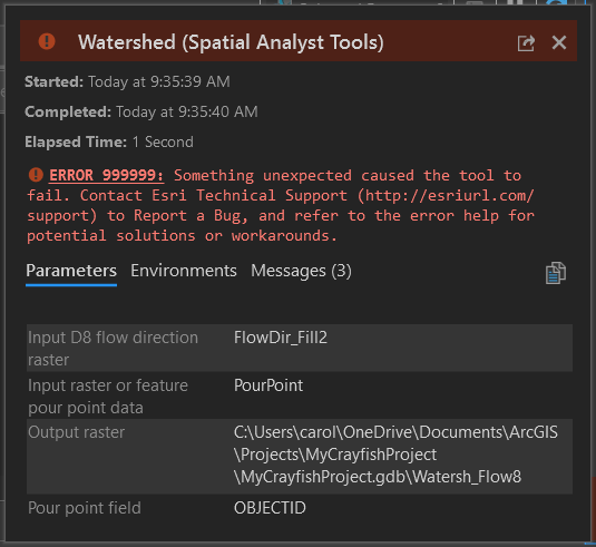

I am trying to create a watershed. I have successfully (so I thought) created DEM, fill, flow direction, flow accumulation, and a Pour Point. I did have trouble snapping the pout point but I think that is resolved. When i try to run Watershed, I get an error. i've tried moving the Pour Point, renaming files and pretty much everything short of stangin on my head.
Can a kind person help?
Thank you in advance!
Screenshot attached.Screenshot 2024-12-04 093701.pngScreenshot 2024-12-04 093621.png

try saving the output raster to a non-onedrive folder with a *.tif file extension

I've seen similar issues resolved by doing what Dan has suggested, saving to a folder with the .tif file extension should work
