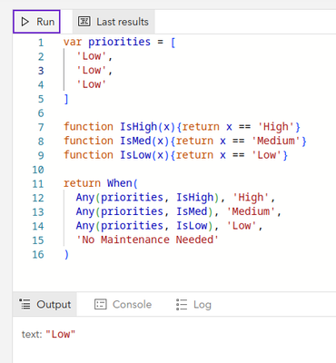

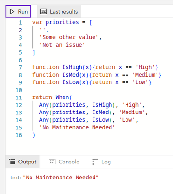

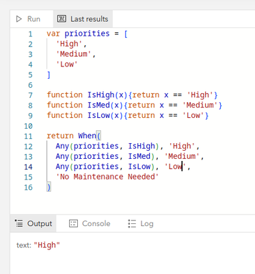

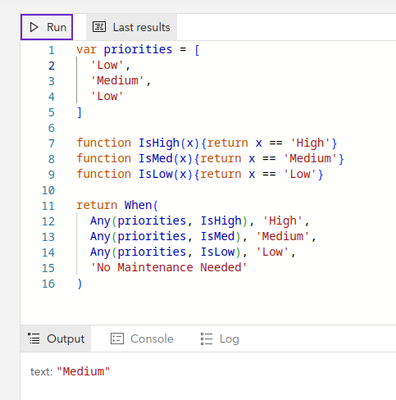

Check out the function Any. It requires you to create a custom function for checking specific values like this, but it's pretty nice. No need for counts or loops.
var priorities = [
  $feature.Priority_1,
  // and so on
function IsHigh(x){return x == 'High'}
function IsMed(x){return x == 'Medium'}
function IsLow(x){return x == 'Low'}
return When(
  Any(priorities, IsHigh), 'High',
  Any(priorities, IsMed), 'Medium',
  Any(priorities, IsLow), 'Low',
  'No Maintenance Needed'
- Josh Carlson

Hey Josh, this works perfectly! I don't have a lot of experience with functions. I can piece together the Any function as part of the return, but I'm wondering if you'd be kind enough to explain the isHigh/isMed/isLow functions. How does that 'x' work in those?

The function Any acts against an array. From the Arcade docs:
Tests whether any of the elements in a given array pass a test from the provided function. Returns true if the function returns true for at least one item in the input array.
So, after the array, the other parameter is a function name. Any will essentially loop through the array, apply that function to every item in the array, and tell you if any of them yielded a "true".
In some cases, you can use a built-in function like Boolean or IsEmpty, but for our case, we want to check if any of the values are equal to "High". Since no function exists that does this, we make our own.
In Arcade, we can define our own functions, and when we do that, we use placeholder variable. It might make more sense if you saw a custom function used in a more normal context.
function SaySomething(text, name){
  return text + ' ' + name
return SaySomething('Hello', 'Zach')
That code would return the text "Hello Zach". The parameters 'text' and 'name' in the function are only being used to define how the function itself works.
So, those functions I defined are taking whatever gets passed into it as the variable x, then simply checks to see if that thing is equal to "High", etc. I could have used anything as the placeholder, I just picked "x".
When you refer to a function in Any, you don't give it any parameters. What it does is run the function against every item in the array, and it inserts each item as the parameter.
- Josh Carlson
