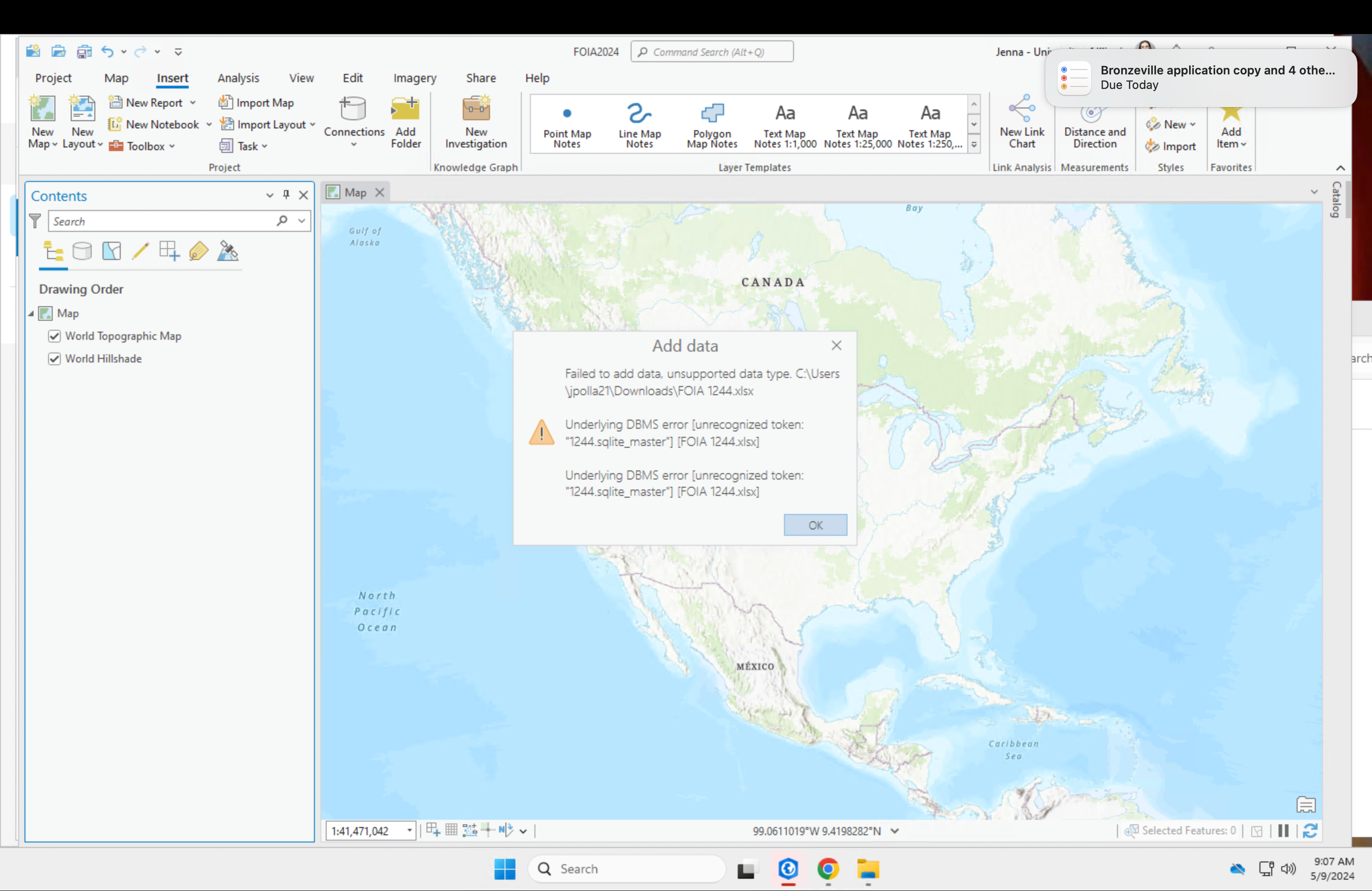

2) I tried to plainly import the .csv into the program and got this error:

@JennaPollack What were your steps to add the sheet from your Excel file? How did you try to add the csv?
Also remove the space from the name of the excel file and replace it with an underscore before trying to geocode it.

JennaPollack
Thank you so much, that did it!
