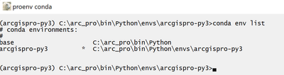

remove any environments that you have attempted to create as described in the document
use Windows file explorer and locate these two folders
C:\.. ArcGISPro install folder..\bin\Python\envs
  • there should be   C:\.. ArcGIS Pro install folder..\bin\Python\envs\arcgispro-py3  unless there are some clones there, which need to be removed
C:\Users\.. You ..\AppData\Local\ESRI\conda\envs
  • clones here need to be removed.
Is this where you have been installing your software and clones?
If not, do so and report.
If you tried multiple locations, you may have stray environments listed and the package manager won't help and you will have to go the "conda" route
I create a desktop short cut to
Target:   C:\arc_pro\bin\Python\Scripts\proenv.bat
Start in:  C:\arc_pro\bin\Python\envs\arcgispro-py3
so I can run it easily.  (note, I install Pro in my own folder (arc_pro) rather than Programs..blah...blah
cheat sheet conda-cheatsheet.pdf
or get back with details
