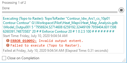

I have absolutely no idea what this tool is looking for for an output extent. I have tried "default," "current map extent," and, the one I thought was bullet-proof - I entered the input contours.
It is rejecting everything I throw at it.
Would appreciate any advice anyone is able to offer.

Are you using the tool in arctoolbox or are you using a model?
screen grab the toolbox tool inputs if you are using the former

Using it in a model. I changed it to "default" and it's working for now. That would be ideal. Earlier, I had not had good luck with "default" - It plugged 0,0,10,10 in for some reason. Fingers crossed.
