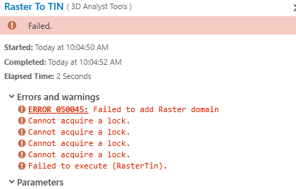

To test, I decided to use the input of an invisible raster to a tool (Raster to Tin).
With ones that were run from modelbuilder, I get this error:
Which I do not understand at all. Why does it matter if the input has a lock? It's not being altered.
When I use a raster created outside of the workspace, it runs fine, no errors, no locks. A tin is created.

Checked a couple other tools. They reject the input raster if it was created within model, Got a nice "Unknown error. Contact ESRI Support."
The model builder is doing something to this tool, but I don't know what it is.

050045: Failed to add Raster domain.—Help | Documentation
don't know what the boundary should have to do with it, but that is the error.

Thanks Dan. Turns out, I've blundered into a bug.
https://community.esri.com/thread/250935-arcgis-pro-25-topo-raster-tool-fails-to-generate-an-output-...
I have a feeling that error is not a "real" error. Just something thrown up by a failing process.
