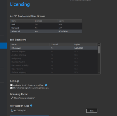

Running the tool like the example, I get "ArcGIS for Desktop Advanced license not available" which I know is wrong because I triple-checked that I have the advanced license (screenshot below). When I run arcpy.CheckProduct("arcinfo") as is in the python window, I get the message 'AlreadyInitialized'. Another development, when I run the tool from the Python window after copying the python command from the geoprocessing pane it runs fine.
