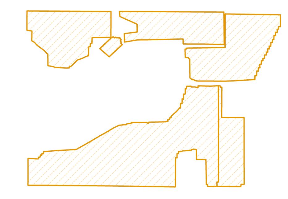

The buffer and fishnet tools seem like they would work well for rectangular areas. However many of the areas I'm working with are irregular, like in the attached pic.
Lets say that the above area encompasses 100 acres. Ideally I can create 100 different sampling points evenly (as much as possibled) spaced within the above polygons. Perhaps this could be accomplished by converting the polygons to raster datasets and then using the center of the raster cells as my sampling locations?
DanPatterson_Retired
MVP Emeritus
or just create a fishnet over the area (like a raster cell), and get the label points for the ones you want to keep... a little bit manual, but if you are looking for the one-button-solves-all solution, it may take more time to find it or write it than to put some quasi-automation-human-selection into it
