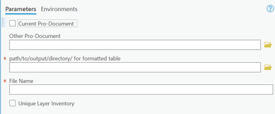

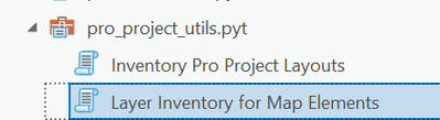

I have a Python Toolbox built already that you are free to use:  pro_project_utils (Python Toolbox)
  • The first tool will inventory all Layouts in a Project (aprx) and which maps are used in it.
  • The second tool is what you want, it inventories all layers in all maps contained in a Project (aprx).
I believe I can document the arguments, etc to display in the toolbox so you can click and determine arguments and outputs.  If you intend to use, let me know and I will update on GitHub.  But in general here are the arguments for Layer Inventory for Map Elements (second tool).
  • Click "Current Pro Document" if you are using tool within the Project to inventory
  • Otherwise, provide path/to/aprx in Other Pro-Document argument
  • path/to/...formatted table will be a DIRECTORY where inventories (.csv) will be saved.  Note, if Unique Layer Inventory is checked, then there will be two inventories (see last bullet)
  • File Name can be a <filename>.csv or simply <filename> and the output will be a .csv
  • Unique Layer Inventory fairly certain this will have one row per feature/.shp/.tif/file visible (i.e. checked to diplay) in Table of Contents for every map used in a Layout in specified project.  Note that in this situation, TWO .csv will be exported, one with unique layers and one with all layer listed for each map.
