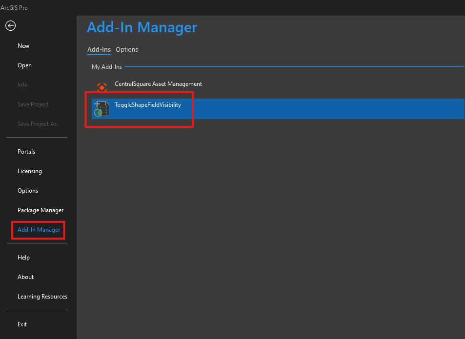

@MelanieWawryk, this is in response to your post Bring back shape field visible fix when publishing services. I could not reply with an attachment there. I have several projects with 100-200 layers, and some of them have the shape field turned off. I tried the Python route but did not work, but I did get it to work with the attached Add-In tool. This was built on ArcGIS Pro 3.4, so I have not tested if it is backward compatible with 3.3.x or earlier.
Installation Instructions
1. Download and extract the `ToggleShapeFieldVisibility.zip` file.
2. Open ArcGIS Pro.
3. Go to the `Add-In Manager` in ArcGIS Pro via `Project > Add-In Manager`.
4. Click `Add From File` and select the downloaded `.esriAddInX` file.
5. The widget should now be available in the ArcGIS Pro ribbon under the configured tab.
