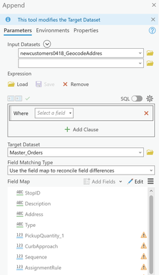

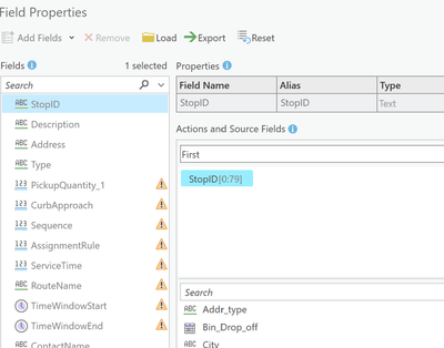

If you want to select a row from one table/feature layer then append it to an existing table or feature class, use the Append tool.  It's often the case that the attributes of the  input rows are being appended to an existing table/feature class don't match up.  For example, the input might have a field named "ClassID" and the table you're appending to (the Target dataset) has a field name "ClassName" and you want the values of ClassID to be put into the ClassName field.  Because this is a common use case, Append has a Field Map control that allows you to do all sorts of stuff to match up input and target fields.

To copy into an existing table, use the geoprocessing Append tool, NOT copy features. Append has its own Field Map control in its dialog, separate from Transfer Attributes in the project's Editor tab.
Clicking Edit on the field map brings up Field Properties where most of the action is.
The input to Append can be a layer in your map with a selected set of records.  Those selected records are what are appended into the target dataset.
