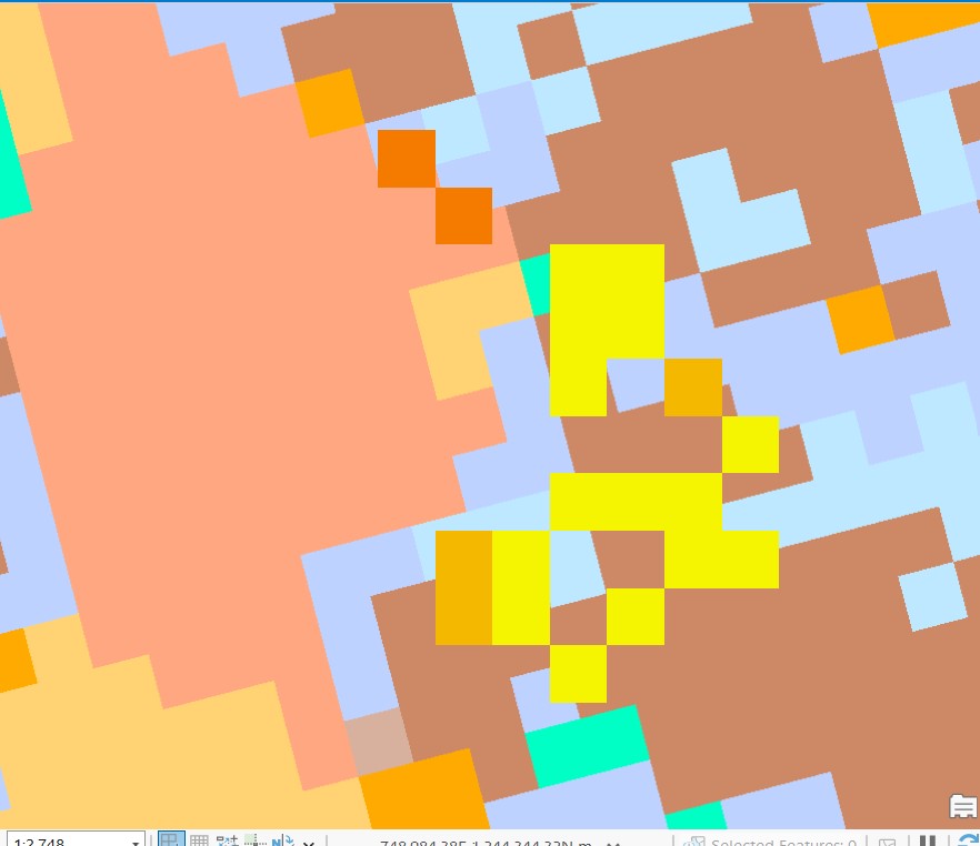

I am struggling with comparing to raster layers because one of them is at a different angle. I checked the projection and they both match. The pixel types are different one is short and the other is double precision but i am not sure how to change that or what else to do.

Interesting.  Is there a Geographic Transformation applied in the Map View properties by chance?  If so, remove it and see if the raster returns to proper XY axis.

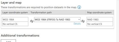

Is this what you mean?
Robert_LeClair
Esri Esteemed Contributor
Yes, for Transformation path, click the dropdown and set it to none.  Does the raster tilt correct itself?
