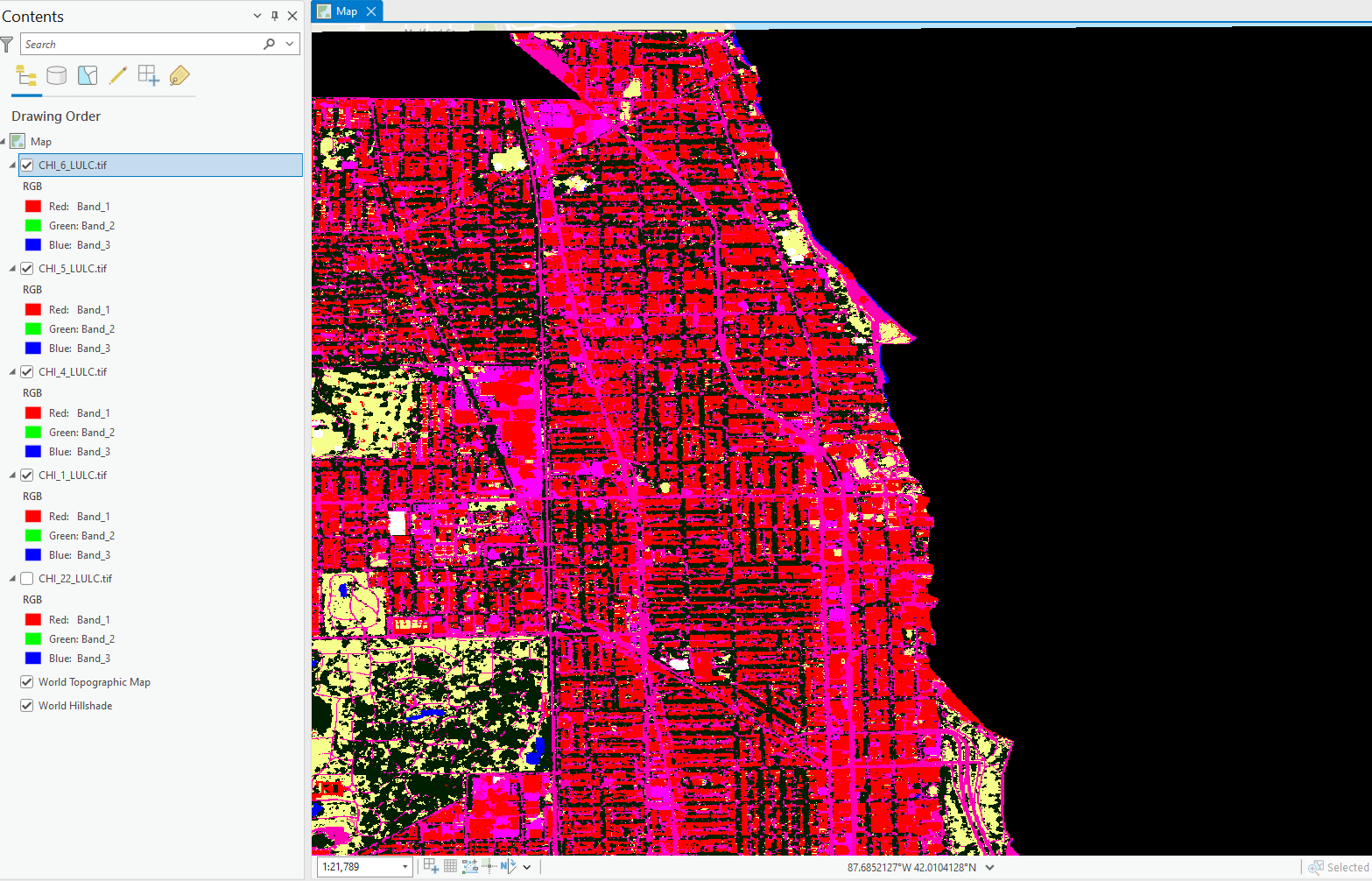

Hello. I am trying to load rasters into ArcGIS Pro Desktop, but the land use classifications are not appearing; instead I am seeing RGB (Red Green Blue) bands when I load the rasters.

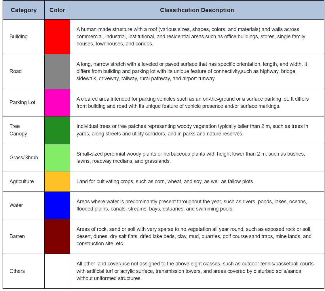

For context, I am using great publicly available 1m by 1m raster land use data by Univ of North Carolina (https://urbanwatch.charlotte.edu/product). Here are the land use classifications:

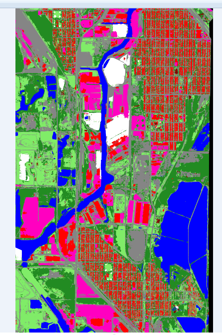

and here is the image of one of the .tif files when I just open it up on my computer as a photo:
As you can see, there are a variety of colors representing the different land classes. Theoretically, I should be able to load this .tif and then click on an area and uncover the land class.
But when I load in the .tif files, they are showing up as RGB, shown here:
Is ArcGIS Pro Processing the .tif's incorrectly? How can I get these classifications to appear?

Luke_Pinner
MVP Regular Contributor
I downloaded a couple. They're definitely 3 band RGB (tested with GDAL and QGIS as well) with no attributes.  I think it's just a poor choice of  output format by the authors.
However, it's a very simple classification:
255,0,0 = Building
133,133,133 = Road
128,236,104 = Grass/Shrub
34,139,34 = Tree canopy
etc...

Dear Luke, Thanks for simplifying this problem. Would you recommend that the next step is to consolidate the RGB tiff files into a mosaic, and then supervise classify the pixels of the mosaic? (Not sure if I used the right language in my question..)
So, I mean just input the values for RGB and create a label and color based on the classification. P.S. Did you obtain the pixel values by sort of spot checking? I spot checked by referencing the .tiff images and got these values, similar to you:
255,0,0 = Building
133,133,133 = Road
255, 0, 192 = Parking Lot
0, 0, 255 = Water
255, 255, 255 = Other
128, 0, 0 = barren
255, 193, 37 = Agriculture
