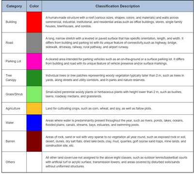

For context, I am using great publicly available 1m by 1m raster land use data by Univ of North Carolina (https://urbanwatch.charlotte.edu/product). Here are the land use classifications:

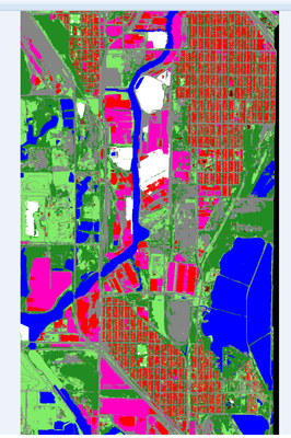

and here is the image of one of the .tif files when I just open it up on my computer as a photo:
As you can see, there are a variety of colors representing the different land classes. Theoretically, I should be able to load this .tif and then click on an area and uncover the land class.

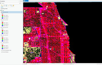

But when I load in the .tif files, they are showing up as RGB, shown here:
Is ArcGIS Pro Processing the .tif's incorrectly? How can I get these classifications to appear?

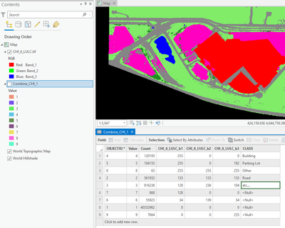

Luke_Pinner
MVP Regular Contributor
Another way would be to Combine (Spatial Analyst) the 3 bands.
You need to add them to the map (or tool) separately, not as the tif. e.g.
The output will contain the RGB values as fields.  You can then add a class field which you can update from the known RGB values:

Luke_Pinner
I downloaded a couple. They're definitely 3 band RGB (tested with GDAL and QGIS as well) with no attributes.  I think it's just a poor choice of  output format by the authors.
However, it's a very simple classification:
255,0,0 = Building
133,133,133 = Road
128,236,104 = Grass/Shrub
34,139,34 = Tree canopy
etc...

Luke_Pinner
