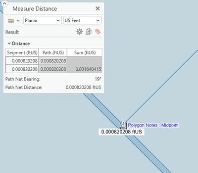

@MatthewParkman I see. That is definitely larger than the XY tolerance. Can you send me that project? I just tried your steps in my own map and I don't see a significant gap:
I'll DM you my email address
MatthewParkman
Sure thing. Thanks for taking a look at it. Multiple users in our organization have seen similar phenomena.
