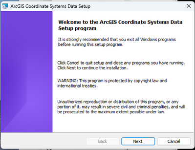

Have you tried loading the CoordinateSystemsData for ArcGIS Pro? The installer is available from my.esri.com, downloads. These are needed if you did a per user install vs. per machine.

@RichardDaniels  Thank you, I found it was not installed and do not have access to the code, the following is a good and easy fall back.

It really sounds like you're missing the Coordinate Systems Data required to do on-the-fly transformations of the data to another datum. Install the ArcGIS Coordinate Systems Data installer package to test this.
