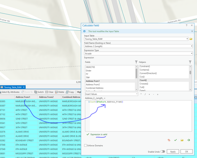

I am trying to use Count() for a simple count of a string in a text field in a feature table in Pro.
It should be as simple as Count(fieldname)
Error
Works on another field
Both are text fields

Oh, right! It uses that first row to validate the script. Okay, try an expression like this:
var addr = $feature['Address_From2']
Iif(IsEmpty(addr), 0, Count(addr))
 By checking if the value is null first, and explicitly giving nulls an output value, this should pass validation.

Hmmm. Does it behave any differently if you use bracket notation? As in, $feature['Address_From2']?

RyanBohan
Thanks for the suggestion, I am still getting the error.
It appears if the first row is <null> that is when the error happens.  I am using ArcPro 2.9.2
I am pulling in a csv, and exporting the table to gdb
Current work around is adding in a dummy row of values.
- Josh Carlson
Kendall County GIS
RyanBohan
Thank you @jcarlson!  That does it.
