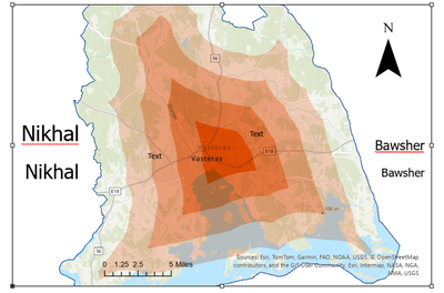

Faiez
Hi!
From dynamic option, select map fram and write this under text view as shown below:
<dyn type="mapFrame" name="Map Frame"/> Nikhal
There might be some problem with the combination of dynamic and static text.
From this option, it works well:
Good luck.

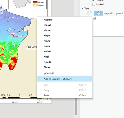

Eugene_Adkins
I believe if you right-click the identified word you can add it to Pro’s list of “correct” words with the custom dictionary option.
HajarAlqayoudhi
Hi Eugene
Thanks, even when I add this option it doesn't work 😞

HajarAlqayoudhi
Hi Faiez
Thanks Hero, It is worked  with me 😀

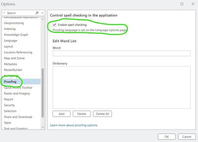

TomBole
Hi @HajarAlqayoudhi
You asked how to disable the spell check. This can be done in the Options dialog (Proofing tab).
For more information please see the help topic Set proofing options.
Hope this helps,
