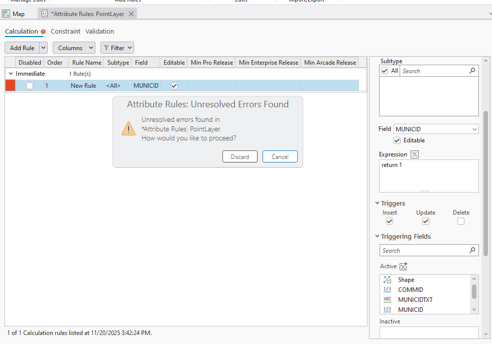

Good afternoon,
I am creating my first attribute rule, and I created a rule that populates a numeric field with the value 1.
I am working with a file geodatabase.
I get an error message "Unresolved Errors Found". How can I check them?
Thanks
BrendanNewell
Hey @SanchezNuñez  if you hover over the red square within the row of the attribute rule it should give you a useful error message.
Also you may need to create global ids for the feature class.
